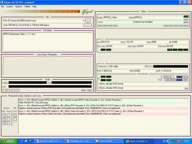

    post a g-spot screenshot of the video details

    Here is the g-spot screen of the converted file, as you can see it's NTSC.
    Just one more thing. after authoring the dvd, the VOB file is playing smoothly when it plays directly in any player. But when using software that plays DVD (power dvd, dvd x player), the video is running not smoothly and looks chopy when there is movement on screen.
  5. This is from DV-AVI source(GS300 camera)? What field order did you select when converting to mpeg2? DV-AVI is usually bottom field first. You need to re-encode to mpeg2 using bottom field first(BFF).
