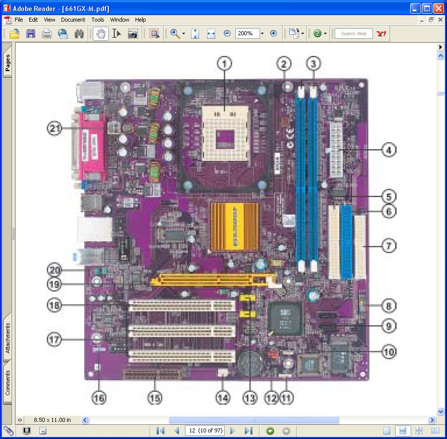

  1. My daughter's eMachine T2542 died. Online info suggests high rate of failure of this motherboard.
    When turning it on, nothing much happened except the power supply fan turned much slower than typical speed. A "Guru" told me this was almost 100% a motherboard failure, probably without damaging the CPU (Celeron 2.5 ghz).
    Sounded like a m/b upgrade project to me . . .
    Ordered an ECS 661GX-M from Newegg.com, based on the listing that said it was Pentium 4/Celeron-compatible, micro-ATX, etc.
    Installed m/b, checked everything, turned it on. The power supply works at "full fan" speed, CPU fan spins, but nothing beyond that: Nothing onscreen. Pressing the on/off switch to turn it OFF does NOT work, which may be a hint as to my problem, whatever it is.
    I've tried different RAM modules which match the m/b's specs without success (the modules work okay in another computer).
    I have no way to tell if the CPU is also fried without taking it to a repair shop. Or do I?
    The installation manual for the m/b does NOT mention Celeron compatibility, but a feedback comment from another upgrader on NewEgg's website indicated success with a Celeron 1.7ghz CPU.
    Any ideas? Perhaps I have a DOA m/b?

  18. Member pchan's Avatar
    Mar 2003
    Singapore
    Please try the following.....
    1. Strip your PC to the bare minimum. Only CPU, RAM (one module at a time), PSU, and video card. Power on and it POST where you see text display on the screen. The will be a short beep if it's OK. Long beep.... not OK. Check your RAM module. Maybe its not sitted properly.
    2. Start adding on other components if you get pass 2.
    3. Did you connect the ATX2 power connector (4-pin). Top left coner (label 21).
    It will not boot if it's NOT connected.

  30. [quote="pchan"]Please try the following.....
    ____________________________
    Thanks for the suggestions.
    o PC is already a "bare minimum" configuration, based on your criteria. Video is built-in. Original eMachine chassis did NOT come with a speaker. I'm about to scrounge one elsewhere and see if I can get the "beep" you describe.
    o I've tried different compatible RAM modules from working machines, in both sockets. RAM from the original machine works in another PC I have (AMD).
    o ATX2 connector attached.
    Seems I'm in a bit of a chicken-and-egg situation: Can't tell if the m/b is bad without a known good CPU, and I can't tell if the CPU is bad without a known good m/b.
    May have to bite the bullet and take my DIY project to the shop . . . .
    I'm still wondering if the fact that the on/off switch will turn the system ON but not OFF isn't some sort of clue as to what's going on . . . . ? I have to turn it off via the on/off switch on the new PS.
