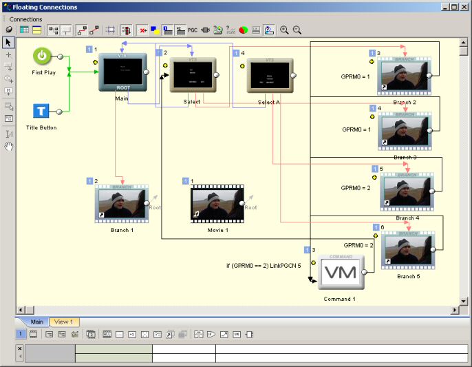

I do hope you will forgive me for butting in here - but I'm glad I came across this thread - referring to the Chapter List part of PharmBoy's post. I wanted to do a similar thing for an instructional video:- main menu (Play Movie, Chapter Select), sub-menu (Return To Main, Chapter 1, Chapter 2,...) - and for selected chapter, the chapter returning to the sub-menu. I purchased DVDLab Pro to do this, but struggled for ages, experimenting, re-reading the manual and any tutorials etc. that I could find - and eventually came up with the chapter list solution. This post has confirmed for me that this is the correct way to go about it.
Something I did in additon (which PharmBoy has probably worked out for himself), is to make the button from which the chapter was played be highlighted on return.
First I drew a link from each sub-menu chapter list to the sub-menu.
My first try (which worked) involved using a GPRM, set in the PRE commands of the Root menu and each of the sub-menu chapter lists, and using it to set the appropriate button highlight in the sub-menu. Then I discovered that all one has to do is set the Hi-Lite Default Btn in the PBC tab of the sub-menu to zero. (See Connections/Hi-lite Button in the manual, last line of the page).
I then went one stage further and had two sub-menus (with Next and Prev buttons) to simulate the case where there are too many chapters to fit in one sub-menu. I set a GPRM in the PRE command of each chapter list to indicate which sub-menu to return to; added a VM command and linked each chapter list to this; linked the VM command to the first sub-menu; then added code to the VM command to test the GPRM and link to the second sub-menu if appropriate. Obviously this could be extended for any number of sub-menus.
I thought I'd pass this on in the hope that it will save someone else new to DVDLab Pro from hours of reading and experimenting. Also to see if anyone has a better way of doing it (though this seems pretty simple).

I should have mentioned that this is a hobby for me. You as well as most everyone else in here has certainly taken it up a notch. I am sure that these questions will come up again and people will appreciate your posted pic.
