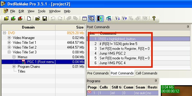

    Here is the standard menu after a merge:
    Both buttons use LinkTailPGC which means go to the post commands.
    You can see that in the post commands, line 1 sets register 0 to highlighted_button. Line 2 checks the value to determine if button 1 or button 2 was pressed, and if the register value is equal to 1024 then it jumps to VMG PGC 2, otherwise it skips to line 5, which jumps to VMG PGC 4.

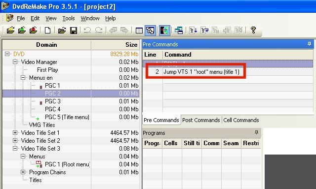

    VMG PGC 2 jumps to the root menu of VTS 1 (aka Disc 1's Main Menu).

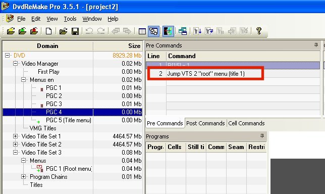

    VMG PGC 4 jumps to the root menu of VTS 2 (aka Disc 2's Main Menu).
