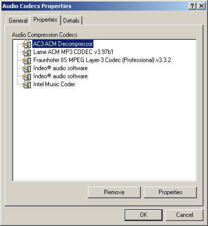

BUT looking for some advice on Google, I found the culprit might be ADPCM codec which is NO more registered for working with WAV files by default. Although I have MSADP32.ACM in \SYSTEM32 folder, looks it is no more registered.
In fact, have a look at attached photo. I'm sure there are missing some very important Microsoft audio codecs. Audio codecs that I have are installed by K-Lite Codec pack. Please compare with your PC.
HOW can I restore them?

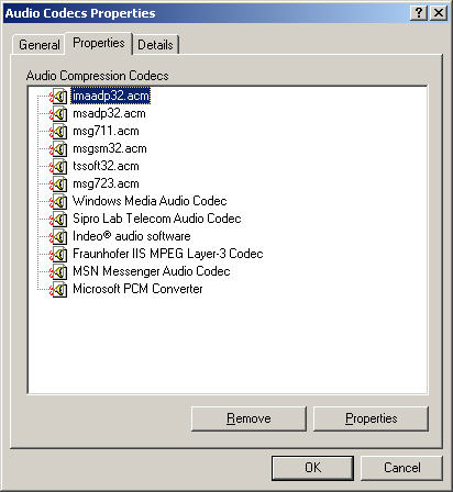

Glad to help. Spread the news with or without credit. I bet other people have same issue judging by the forums I searched on, and all ending in UNsolving it.Originally Posted by jrui
And here is all audio codecs that Windows XP installs by default and you should always have in order to play system sounds and stuff.
Cheers
