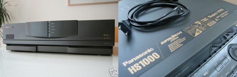

I don't like my jvc picture quality , really , OLD machines does a better job. Comparing a lot of tapes , almost seems better in the panasonic. I would like to buy a pro VCR (panasonic AG) or the end model of the NV-HS series (Panasonic NV-HS1000). This model have TBC and DNR. Seems interesting.
