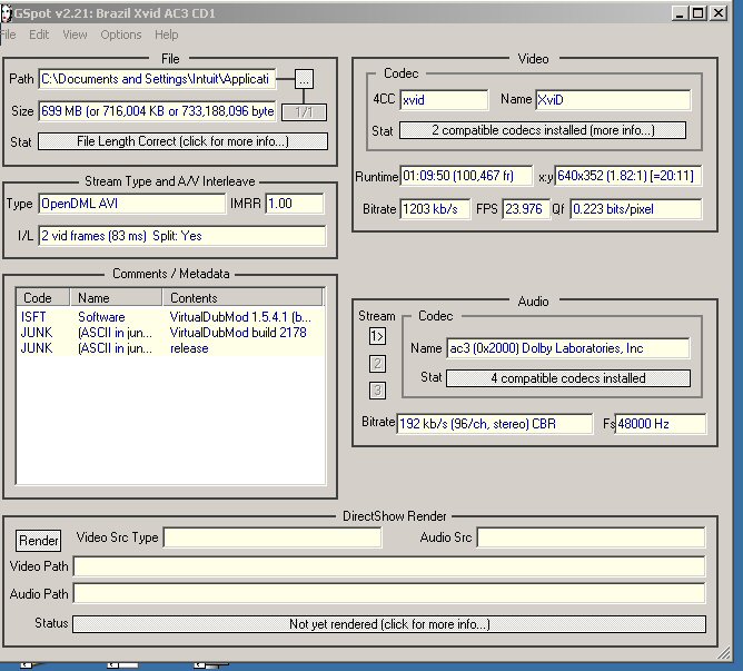

GSpot screenshot:

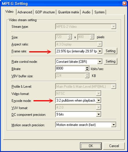

I can't find a setting for TMPGEnc where it says 23.976(internally 29.976)... I can only pick one or the other. I have tried both TMPGEnc Plus and regular TMPG...

Hey I see no 2:3 pulldown...only 3:2Originally Posted by guns1inger
Is there another option out there that is 2:3? -
Use 3:2 Pulldown, if that's the only choice. 6 of one and half a dozen of the other.

You can encode a 23.976 fps progressive source as 29.97 fps interlaced, or you can encode as 23.976 fps progressive with 3:2 pulldown. The latter gives better results and requires less bitrate.
