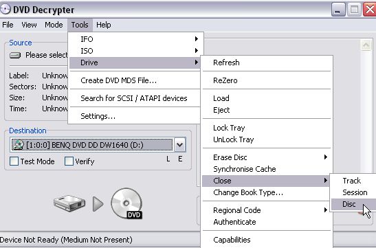

    Usually but use DVDDecrypter to rip(IFO mode),it also has a finalize feature for DVDR:

    I know but I thought I would mention it for future use.
