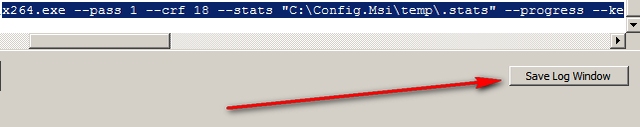

Sure, but the easiest way is to copy the processing logs of AutoMKV (specifically the X264 lines) to a .BAT file. AutoMKV is a pretty good app as it is.
Here's a 2 pass example snagged from the log:
x264_encode.cmd -
Hi All!
about AutoMKV a quick view of command line can be obtained in Advanced Profiles Editing, at botton is show the command line
changing the profile, or editing the xml and ckecking "Use this profile" will update the command line at bottom
and about upconversione.. i suggest to try with automkv the LanczosmtPlus , only for upconversion (just write a bigger value than actual width in Width or in Manual Cropping), otherwise automkv will switch to lanczos
