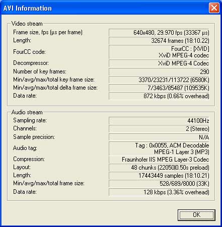

-To the second one here's a pic showing what VirtualDubMod tells me about the file (already muxed with the MP3 audio CBR at 128 kbps):
-It could be. OTOH, since Vegas opens VOB files an AC-3 in those VOBs, I preserved the same video properties for the project (interlaced, 29,97, DAR 4:3, PAR, same audio AC-3 48Hz....). The video was converted to Xvid in VDMod (Full processing mode using the filters deinterlace and resize Lanczos3. The audio was converted in Vegas to MP3 CBR 128 kbps and then muxed to the video file in VDMod. I have also tried changing the audio properties for the project selecting stereo and 44.1 Hz and render the file again to MP3.. Same result: sync problems.I'm wondering if one of the conversions changed the audio length?
-Thanks, I'll give it a try. Thank you, really.You could certainly try using VDM with the VOBs directly and skipping the Vegas step. Less handling is always better.
-Absolutely not. Everyting is perfect; the Xvid video, the audio, but there's this backward: a sync problem.I'm wondering if the short clips are also out of sync, but not enough to notice?
