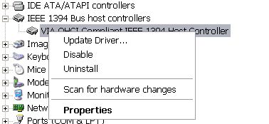

If that doesn't work, you can try uninstalling the driver in Device Manager and let it reinstall during reboot.
