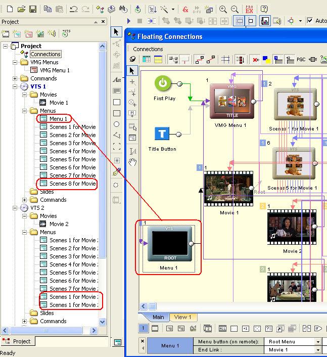

I’ve managed to [almost] finish my multi-movie compilation but I got a few menus too many and I want to get rid of them (see screenshot 001, items circled in RED). Still haven’t TEST PLAY the project yet.
VTS 1
In VTS 1, I want to get rid of “Menu 1” page and “Scenes 8 for Movie 1” page.
I want to link a button in the VMG menu (default First-Play I guess) directly to “Scenes 1 for Movie 1” page but that option is not available. I managed to do this for Movie 2 & Movie 3 in their separate VTSs. There’s an option to link VMG menu to “Menu 1” but I don’t want that.
I want get of the “Scenes 8 for Movie 1” page because that was created by mistake due to too many chapters in the movie.
VTS 2
IN VTS 2, I want to get rid of “Menu 1” page, “Scenes 1 for Movie 2 A” & “Scenes 1 for Movie 2 B” clone pages. These were also created by mistake as I thought you could clone page 1 & paste to other Scenes Pages for position of the buttons & frames.
Also, I have too many buttons that I dragged-n-dropped in some of the menu pages during the process of editing them. I can't find a DELETE BUTTON option anywhere in DVDLAB PRO. So the next best thing I could do is apply the REMOVE LINK (if I made it into a link in the first place) & INVISIBLE ALL options. Is this OK …. to leave bunch of invisible buttons with no links on the menu?
CHEERS!
You can just highlight them and hit del to get rid of them. This goes for menus and buttons. Any buttons without links will become embedded into the menus as text. If they are invisible, you wont notice. Personally, I'd clean them up to make sure you don't get unexpected behaviour.
The only item that concerns me is Menu 1, because I can't work out what it actually links to, and therefore what damage will be done by removing it. If it is just a blank link between the VMG menu and the Movie, kill it, then read up on using bridges to cross VTS boundries.Read my blog here.
thanks Rock...still can't figure out what's going on...will have to just keep trying stuff, hopefully someone on this thread will read my dilemma and give me some insight.
Thanks gun...got the day off so can put some serious time into finding a solution...if I figure it out I'll post it...if not, I might throw some screen prints that better depict the issue.
Thanks again. -

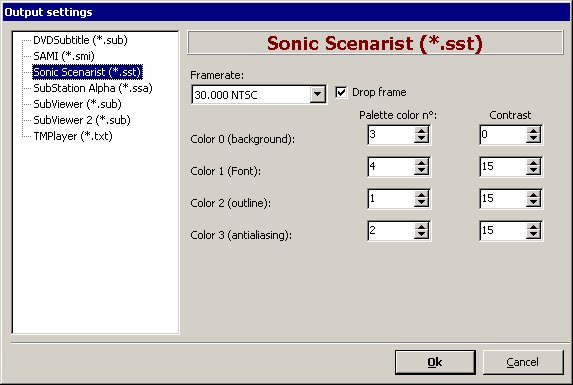

I think nobody has given a proper answer to this particular question, so here it goes:Originally Posted by rock_king_my
Since you have the subtitles in .SUP format, what you can do is use the dvdsupdecode command line tool with the -bitmap option. This will give you several .bmp files containing the subpictures, and a .txt file containing the timing info. This .txt file is formatted very similar to a MicroDVD .sub file. You can open it with a text editor, get rid of the { and } surrounding the names of the .bmp files (a couple global replaces will do that), and then save it with a .sub extension. Then you can open it with Subtitle Workshop (as a MicroDVD .sub file) and save it as a Sonic Scenarist .sst file. Voilá! That .sst file and the associated .bmp files CAN be imported by DVD Lab as subtitles. Just be sure to select the color, the other font options will be ignored since this isn't text.
Oh, and both with dvdsupdecode and Subtitle Workshop, be sure to use the right framerate options. For dvdsupdecode, use the -fr:25 parameter for "pal" and the -fr:29.97 parameter for "ntsc", though I think you can also use the -pal and -ntsc parameters alternatively.
In Subtitle Workshop, look inside the "Output settings" for Sonic Scenarist, and use the original .txt file generated by dvdsupdecode to adjust them. Keep in mind that CLUT indexes in the .sst file start at 1 instead of 0, so you have to add 1 to each one, and the order in the Subtitle Workshop settings is inverted. For example, if the original .txt file contains:
in Subtitle Workshop's Output settings for Sonic Scenarist you'd have to select:Code:FrameRate=29.97 Palette=1032 Alpha=FFF0
