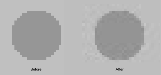

All of those things happen. The most obvious problems are macroblocks and ringing (or mosquito noise) around high contrast edges.Originally Posted by dphirschler
8x, nearest neighbor enlargement of mosquito noise:
This is an artifact of DCT compression and happens regardless of the bitrate chosen. -
