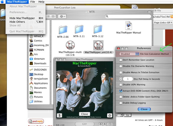

  16. Member terryj's Avatar
    N35°25.24068, W097°34.204
    Prefs for MTR are under
    the MacTheRipper Menu-->Preferences
    (see screenshot)
    I got my 10.4(unibi) build from GB..he sent me the links for being a
    good little donator. You should have had them, if you donated to the cause.
    one for 10.3.9 build, one for 10.4(unibi) build...
