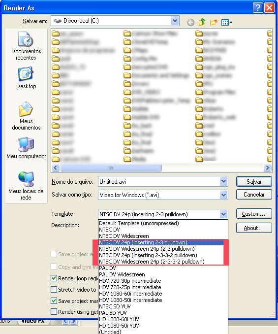

Thanks for your explanation. I posted this topic because I was reading Vegas' manual on how to remove pulldown. They came up with this explanation stating that 3:2 pulldown removal is never perfect, only 2:3:3:2. Don't know why.

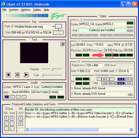

-When I load all my MPEG2 videos rendered in TMPGEnc at 23,976 in GSpot, all of them show those figures above (23,976 Pics/sec and 29,97 Frm/sec). That's why maybe the future must be Xvid, Divx or any other Codec than MPEG2. When I load my own videos rendered in LW at 24 and encoded in Xvid at 23,976, GSpot says simply (23,976 Pics/sec as well as 23,976 Frm/sec). Of course Maximum Frame Interval there is 240 for 23,976 videos and 300 for 29,97 - but no trace of pulldown at all there. Please correct me if I'm wrong.
-Do you want an example? Please download my video blade_runner_sao_paulo
It was encoded directly from Targa sequences rendered in LW at 24. Totally progressive leaving the pulldown for the player (as it shoud be - instead of 3:2 pulldown first, and then encoding at 29.97 fps interlaced which the player will send to the TV as 59.94 fields per second.

First of all let me blame it on Sony, since the manual that comes along with Vegas is so poor and confusing when tries to explain pulldown removal for purposes such as reediting/reencoding video sources. In fact, many people reedit and reencode theis MPEG2 / AVI video files. Some files, do need pulldown removal (23,976 that has been pulldowned to 29,97 2;3 interlaced or AVI 23,976 with pulldown at 2:3:3:2).

3)AVIs from Camcorders recording video at 24: are pulldowned to 2:3:3:2 to make them compatible with TVs. You must remove pulldown when capturing the video. Frames are reconstructed accurately.
4)AVI DV as Scott has put itcan be rendered as 24 fps with pulldown 2:3 or 2:3:3:2. I guess both (?) need the pulldown removal. Here are the options when you hit Render As in Vegas and choose Video for Windows (*.avi)The "Advanced Pulldown" 2:3:3:2 is really ONLY for DV (and maybe HDV) capture. You won't (or SHOULDN'T) see it in any other codec, or at any other stage in the process.
