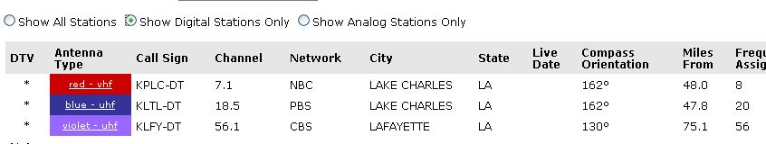

    Enter your home address into www.antennaweb.org . They will list the analog and digital channels available and include distance to transmitter, direction and recommended antenna type factored by transmitter power and topographic obstructions (hills, etc.).
    Small town TV stations often use the minimum power allowed by the FCC to save the enormous power bills. They say why run 500-1000KW for the two guys in town with DTV sets In 2009, the analog transmitters will be shut down and all stations will need to increase DTV power to maximum. Until then, you may need a larger antenna.
    PS:
    Here is a list of stations close to you. NBC is VHF and the others are UHF 48-75 miles away. You will need a medium size roof top VHF/UHF antenna. Good news is they are in a similar direction (~30 degree separation) so odds are no rotator will be required unless you go too narrow focus on the UHF antenna.

    This link lists KPLC-DT as using only 20KW vs 316KW for their analog station so you can see what you are up against.
    http://www.bigcitytvandradio.com/television/louisianatv.txt

    20KW may not be enough power to reach you. Before climbimg on that roof, check that AVS forum to see if somebody else in your town has been successful and the type of antenna used.
    I was giving you a thorough answer so others can use the same links to find out about their local DTV situation.
