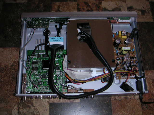

  16. Originally Posted by slr_65
    Hi Jon,
    Welcome aboard!
    It's a nice unit, but we're having trouble with our fan. If you open yours again could you snap a picture of the fan and post it?
    Thanks!
    Steve
    "B" model pics are already posted. Look at the second sticky in this forum - " DVD Recorder models - Picture Quality and Features Analysis".
    Notice how the "B" fan differs from the newer models.
    Here's a pic of the fan in a later model. I think it's an "F". It has the hard drive removed and the longer IDE cable installed so the hard drive can be external.

    Mine looks like the one that was just posted, sitting at an angle, no vents in the back, just on the bottom.
    BTW, there are no warranty seals. I was glad there weren't because I could open mine up and fix the DVD cable issue I had. None of the Walmarts around here had one of these, but I took a trip yesterday, and bought the only one a Walmart that I went past had.
    Jon

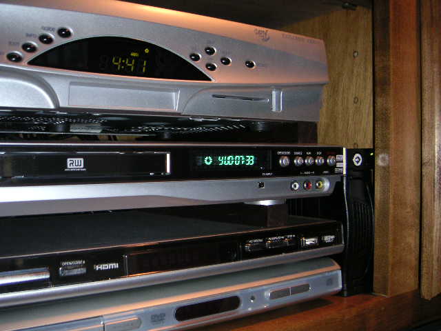

    I see what appears to be an 8300HD DVR in your stack of stuff. Do you use the component out from that to feed the DRM-2001G, or s-video? I'm interested in creating 16:9 anamorphic DVDs from HD content in the 8300. I know I can only record 480i and all of that. If you do this, would you mind doing a step by step on how?
    I have a couple of OTS HD receivers for some local HD programming my cable carrier doesn't carry, but they won't do 480i over component, only 480p, so I'm stuck with s-video on those.
    Thanks.
    Jon

    Yes component from the SA8300HD to the Polaroid (SA8300HD set at 480i). This will allow you to record wide screen. It will not be anamorphic on a 4x3 display though. The Polaroid does not set the wide screen flag. On a 4x3 display the picture is stretched - no letterbox. But on a 16x9 display you will get full widescreen recordings. There will be no artificial letterboxing that you see when using the s-video connection on the SA8300HD.
    In order to get true anamorpic there are two options. One is to take your Polaroid recording via disc and edit on a PC using IFOedit. IFOedit will allow you to insert the wide screen flag. You can then reburn the result. This option to me is too much of a hastle.
    The second is to use the Polaroid as a component to s-video converter and record with a recorder that sets the wide screen flag. In my case I use a Toshiba RD-KX50. Other recorders do this as well. Under this scenario I go component out of the SA8300HD into the Polaroid and then out of the Polaroid via s-video to the Toshiba RD-KX50. The stack I posted above has changed. I have replaced the two DVD players shown with the Toshiba. This process is fast and easy and produces anamorphic recordings that play correctly on both 16x9 and 4x3 screens.
    Some have said that by using the Polaroid as a component to s-video converter I will experience a generational loss and the PQ will suffer. Actual results show that a loss of PQ is not the case. The PQ is excellent. I think the LSI Domino chipset in the Polaroid may be the reason.
    If you are not concerned about how the result will play on a 4x3 screen then true anamorphic is not necessary. Using just the Polaroid will produce full wide screen recordings on a 16x9 display.

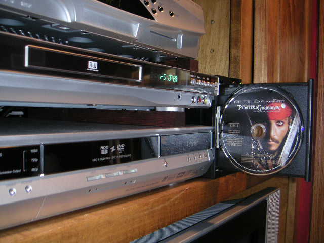

    Here's a pic of the new stack that shows the Toshiba as well as an external DVD burner that is being driven by the Polaroid.
    edit - I should be clear that under the second scenario I am using the Polaroid to just convert and pass the signal. I'm not recording to the Polaroid first and then re-recording it later with the Toshiba. It is a real time pass through process.
    edit # 2 - There is also a third option which is a device placed between the SA8300HD and the Polaroid. This will send the wide screen flag to the Polaroid and thus you will have true anamorphic recording results. It runs about $150. Search "logic design" over at the AVS DVD Recorder forum for info.
