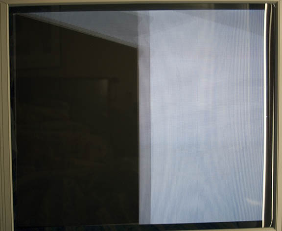

    Unfortunately, I've run into trouble 2 months after purchasing this Polaroid recorder. Today when powering the recorder on, instead of the usual Blue Polaroid logo screen, I get a grey screen with a vertical bar in the middle of screen. What a bummer.... I guess I'm going to have to look into getting this thing fixed, fortunately still under 90 day warranty. I've been enjoying this machine and the quality, putting up with all of its quirks. I've fiddled with the monitor buttion to no avail.
    Anyone else have any trouble with their 2001G or suggestions.?
    Mitch
  26. Member FulciLives's Avatar
    May 2003
    Pittsburgh, PA in the USA
    If it has been less than 90 days and you bought it at WALMART (which to the best of my knowledge is the only place selling it) then you might be able to return it and get another. I think the WALMART return policy is 90 days or less.
    If that is an issue (no receipt or no original box etc.) then buy a new one at WALMART and take it out of the box and put the old one in the box and then return THAT for a money back refund. That might not be "ethical" to some but consider this: your unit should not break down in less than 90 days so ... sometimes you have to do what you have to do.
    - John "FulciLives" Coleman
  27. Member
    Feb 2005
    So. Calif.
    Thanks for the quick feedback. You know, since I was a little leary about buying a Polaroid device, I kept everything including receipt from, yes, Walmart purchase on 9/22/06. I don't usually go to Walmart but I'd expect them to have a pretty good return policy so, I guess that would be the quickest and cleanest option... assuming they have them in stock. I'll probably wait until Sat to avoid crowds.
