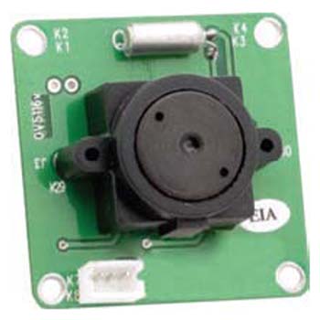

    Web cams are usually based on a inexpensive video cameras like this B&W one, less than $12US retail, about 1 1/4 inch square, with a lens about 1/8 inch dia., so you can imagine the quality is not too good.
    A DV camcorder may cost a few dollars more ( ) and should give you a lot better quality. You will still have to compress the video, probably on the fly, to save on bandwidth. But at least you would have a decent source to work with. There is probably a bunch of 'DV to web converter' programs out there to make using a camcorder a little easier.
