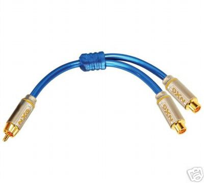

If you are hooking the VCR up to the DVR with RCA (Phono) cables, you could use a 'Y' splitter and run one side to the DVR and the other to the video card, composite in. As long as the signal is strong enough and there is no interference generated by the card effecting the DVR signal. You could do the same with the audio signals, then you would need 3 'Y' connectors and associated cables. Probably other ways to do it, but this comes to mind first. You can get these type of splitters with different ends and lengths to suit your purpose.
