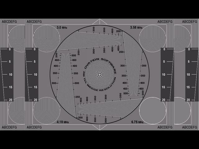

    Here's an example of what you should be seeing. Starting with a 1:1 pixel aspect ratio, 1920x1080, TGA image that looks something like this (this image is half size, videohelp.com may display it even smaller):
    Notice how the image has a 16:9 aspect ratio and the circles are round (some computer monitors do not have square pixels so the circles may not be exactly round on your screen).

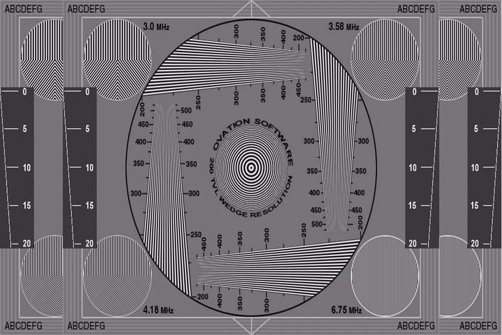

    Then you resize to 720x480 for an anamorphic DVD:
    This image is displayed with square pixels, as VirtualDub would display it. Notice how the circles are no longer round, they are tall and skinny. (In a non-anamorphic encoding the circles would be slightly wider than they are tall.)

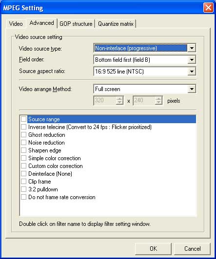

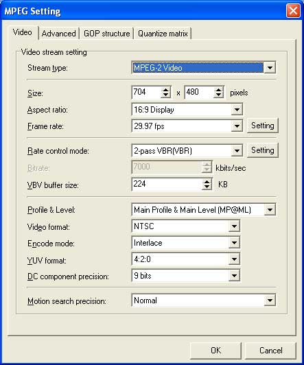

    So let me go over my steps:
    1. VDubMod, import tga image sequence, video->filters->add->resize...new width 704, new height 480, filter mode Lanczo3, leave "Interlaced (not recommended for enlarging)" un-checked, enable "expand frame and letterbox image" and set Frame width to 704, and Frame Height to 480, press OK, then OK again, then start frame server.
    2. Start Tmpgenc Plus v2.5 and load currently running frame server file as video source, and I set parameters as illustrated below:
    Then encode, then multiplex into mpg. Then author in Ulead WS making sure not to rencode, then burn.

    Originally Posted by jfharper
    OK, so I got all this to finally work, but the end result didn't look as good as my other method of resizing the video to 720x405 (1.78)...and adding letterbox at 720x480...I also added a blur to help with some aliasing...but I guess this will only look good when played at 4:3, when played on a 16:9 TV, it will look stretched horizontally, and the letterboxes will never go away...know I don't know what to do.
    How did the picture look within VirtualDub, after setting up the resizing filter? (If you couldn't see the output window you can use Options->swap input/output panes.) It should have looked very clean there. How does the MPEG file look after encoding? It should look good there too. Maybe you are using too low a bitrate for the MPEG encoding? That wouldn't lead to aliasing but would introduce macroblocks. MPEG's 4:2:0 color space and interlaced encoding will lead to some blurring of colors.
    There was more aliasing with the NTSC 16:9 anamorphic method.
    On your TV? Maybe the DVD player doesn't scale the anamorphic image well?
    Is this normal for this process; to see a degradation in quality...I'm talking about edges that are jagged and look aliased?
    There will always be a loss of quality when resizing down from 1920x1080 to 720x480. Resizing always leads to a little jagginess and moire artifacts. But it sounds to me like you are seeing more than you should. Open your MPEG file in VirtualDubMod (because it won't perform any resizing for display), save a frame, and post it. Do the same with your original source so we can compare before and after.
  26. Member Cornucopia's Avatar
    OK...well there is one more thing I don't understand.
    If you divide 16/9 you get 1.78
    If you divide 1920/1080 you get 1.78
    If you divide 704/480 you get 1.47
    If you divide 720x480 you get 1.5
    Use this math:
    HRez / VRez / PAR = DAR
    So you have:
    1920 / 1080 / 1 (1:1=SquarePixels) = 1.78 (aka 16/9)
    and
    704 / 480 / 1.1 (std. NTSC PAR) = 1.33 (aka 4:3)
    720 / 480 isn't truly 1.33, because 8 pixels of black have been padded to the L and R sides, but this has more to do with commonality of sampling rate in A-D conversion, irrespective of TV system (SD NTSC and PAL have same sampling frequency). Consider those 16pixels (=1 macroblock width) "buffer" for overscan.
