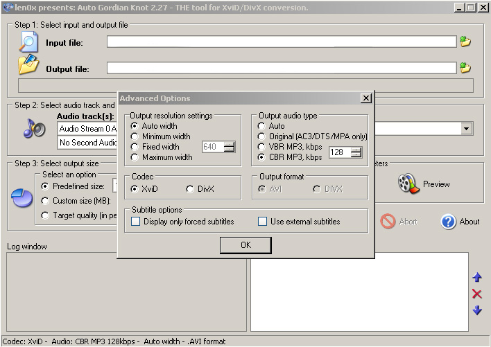

  18. More stupid mentally retarded nonsense that spews from your mouth. You have no idea what you are talking about.
    Nice. You posted a pic of changed settings. An honest mistake, I'm sure. When first installed, the "Auto" box is ticked for "Output audio type". For 2 CD rips, you get the original AC3. For 1 CD rips, the default is ABR MP3@128.
    Step 2: By default the first Audio track is chosen, but feel free to choose another of the audio tracks. If you go for more than 1 CD encode it will be included unchanged (not converted to MP3) with the video. However, if you are doing 1CD or less encode then it will be automatically converted to ABR MP3 (which is a form of VBR MP3) at 128 kbps. Second audio track can be selected as well and it might be the Director's Commentary, or a second language. In this example I've chosen to include main audio track and a secondary track that is a Director's Commentary. This second audio track will be encoded as ABR MP3 at 128 kbps. Advanced Settings (step 4) will allow you to select audio settings manually: whether always leave audio as original AC3/DTS or always convert to MP3. Note that if you are using manual audio settings with two audio tracks then they would both have the same settings. Another thing to remember is that if you are using "target quality" mode (step 3) then by default first audio will be left as AC3/DTS.
    http://www.autogk.me.uk/modules.php?name=TutorialEN
    I think I'll retire from any further discussion with you. Thanks for taking HartsVideo's thread way off track and for trying to drag it down to your level. Feel free to have the last word.
