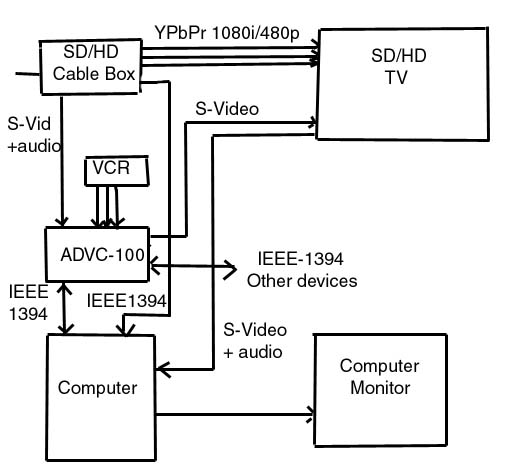

Here is my typical hookup for the ADVC-100.
Using this connection I can watch off air TV, cable (HD or SD), computer or VCR playback on the TV.
The computer can use the cable, TV or VCR tuners for live TV recording. The IEEE-1394 path from the cable box allows HD (1080i or 720p) recording but I usually record HD through the ADVC in letterbox SD 720x480i.
There are also YPbPr paths from various computers via ATI or NVidea HD Adapters to allow HDTV playback to the TV from the computers. There is also a VGA HDTV path from the computer to the HDTV using Powerstrip software.
Not shown is full audio distribution.
PS: WinDV works fine for watching TV on the computer but I can also watch via VLC or my ATI All-in Wonder MMC software. -
