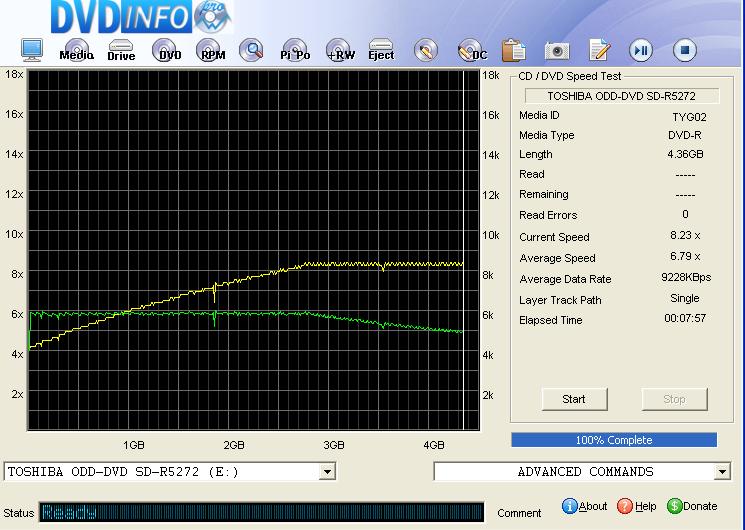

DVDInfoPro is freeware. It will help you identify the actual maker of your Memorex disks. It also has an error check and speed test. If the error check is good, then there are no mistakes on the disk and you should be able to copy to a good disk. I recommend Verbatim or Taiyo Yuden disks.
I have had disks that behave just like yours, they will show no errors but the speed test shows glitches like the one below which occurred with fake Taiyo Yuden disks sold under the GQ label,
A genuine Taiyo Yuden disk gave this result,
