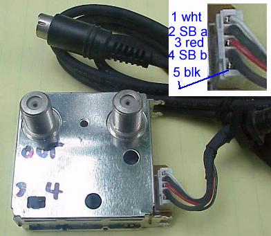

I have this big Sanyo TV that only has an RF connector, so my hookup was to run the DVD unit thru an old VCR to get the 3/4 RF channels. Not an elegant kludge, but it worked...
I found an old RF modulator from a Radio Shack camcorder- its tiny enough to fit inside the DVD unit and simplify the rig.
My problem is ID'ing the pinouts on the unit- there's only 5 wires, I'm thinking there is a common ground, a + 9-12 power lead, an audio out, a video in & a video out.
The unit is a Realistic RF Adaptor RF-152, made in Japan by Jalco. Posting a picture...
I'm thinking the two fat wires are the videos, red is power, white is audio, and the thin black is a common ground for all.
This was for a camcorder and has about a 10' cable ending in a PS-2-like connector with 8 pins and a shield.
I'm mostly wondering about how to sherlock which video is which, and if I can parasite the power for it from the DVD mobo...
thanks for any help!![]()

As you rightly suspect, the red will almost certainly be +ve power but more likely 5 volts than anything higher. Check with a meter as you may also find that the two thicker black wires are connected together and are ground (the ground will also connect to the can of the unit). Once you have identified the +ve and ground, you can then power it up and have a play around. My guess would be white for video and black for audio. Try it, you won't do it any harm if you get them the wrong way round. If you connect video to the audio input you will be able to hear the video signal and if you connect the audio to the video input you'll just get strange patterns on the TV secreen.

anybody got a sense of whether the typical PS in a DVD unit could handle the additional draw of an RF modulator? it's tiny, right? -
It should not be a problem for the recorder power supply. Here is a typical spec for a modulator,
25 mA is not much current for a +5V power supply. The ability of a power supply to supply current drops as the temperature goes up, so designers have to design the power supply to supply the needed current at the maximum expected temperature for the unit. Most recorders can work with ambient temperature of up to 40 degrees C. so at room temperature of 23 degrees C. the power supply can supply more current. -

Hi, I have just used a similar RF adaptor to link my CCTV to my TV system. The connections are exactly the same but I have found that the red is the audio input, white is video input , the two thick black wires are audio and video grounds and the thin black wire is the positive supply. The negative supply is also connected to the common grounds. The thin black wire is internally connected to a TO92 chip which has the marking 8045 on it, which I am assuming is a 4.5v regulator. I have tested the output and it remains at around 4.6 volts with inputs ranging for 5-15 volts, which supports what trhouse stated earlier. My system is working well with a supply voltage of 12volts and has been so for a couple of weeks now. Hope this helps.
