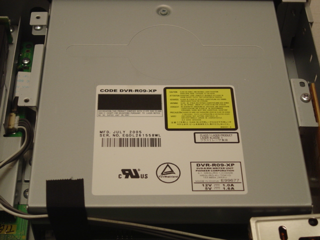

Sorry to hear that. Here is a link to photos I took of the inside of mine. It was none other than TBoneit who commented that the drive looks like a special version of the Pioneer A09/109 drive.

there are sseveral threads here on replacing the Pioneer DDVD drives & upgrading the hard drives to 3-00-500Gb
teh DVd driv eis the easiest 0 you will have to open the box and xamine the DVD drive (do not remove it) and ascertain the model no
it will probably be the special XA series drive ( with extra digital connector.) ie DVR-107-XR ( or something liljke this)
However if you buy the staandard pioneer drive, yu can swap the DVD circuit boards, ie replacing the laser mechanism, but keeping the digital oupput socket and the drive "identity"
search for Pioneer DVd and 420H for more detailed instructions. -

My warranty is up on my 531H in September also. I guess we must have purchased about the same time.
To answer your question about replacing the dvd drive if it is out of warranty. It can be done and gshelley61 has done it ( on a 420 ) in this thread,
https://forum.videohelp.com/viewtopic.php?t=253998
I suspect the procedure is about the same for the 531H and is similar to what needs to be done to upgrade or replace the hdd. I just upgraded my hdd from 80 to 500 GB in the 531H ( 219 hours now available in SP mode ).
The problem is that the drives have an embedded CPRM number which must be entered for the drive to be recognized but the recorder. To enter that number requires a service remote control and a service disk. The CPRM number is written on the back of the recorder to the right of the AC input line. The purpose of the service remote is to allow entering the CPRM number and the service disk is for burning it to memory somewhere in the electronics of the drive. -
