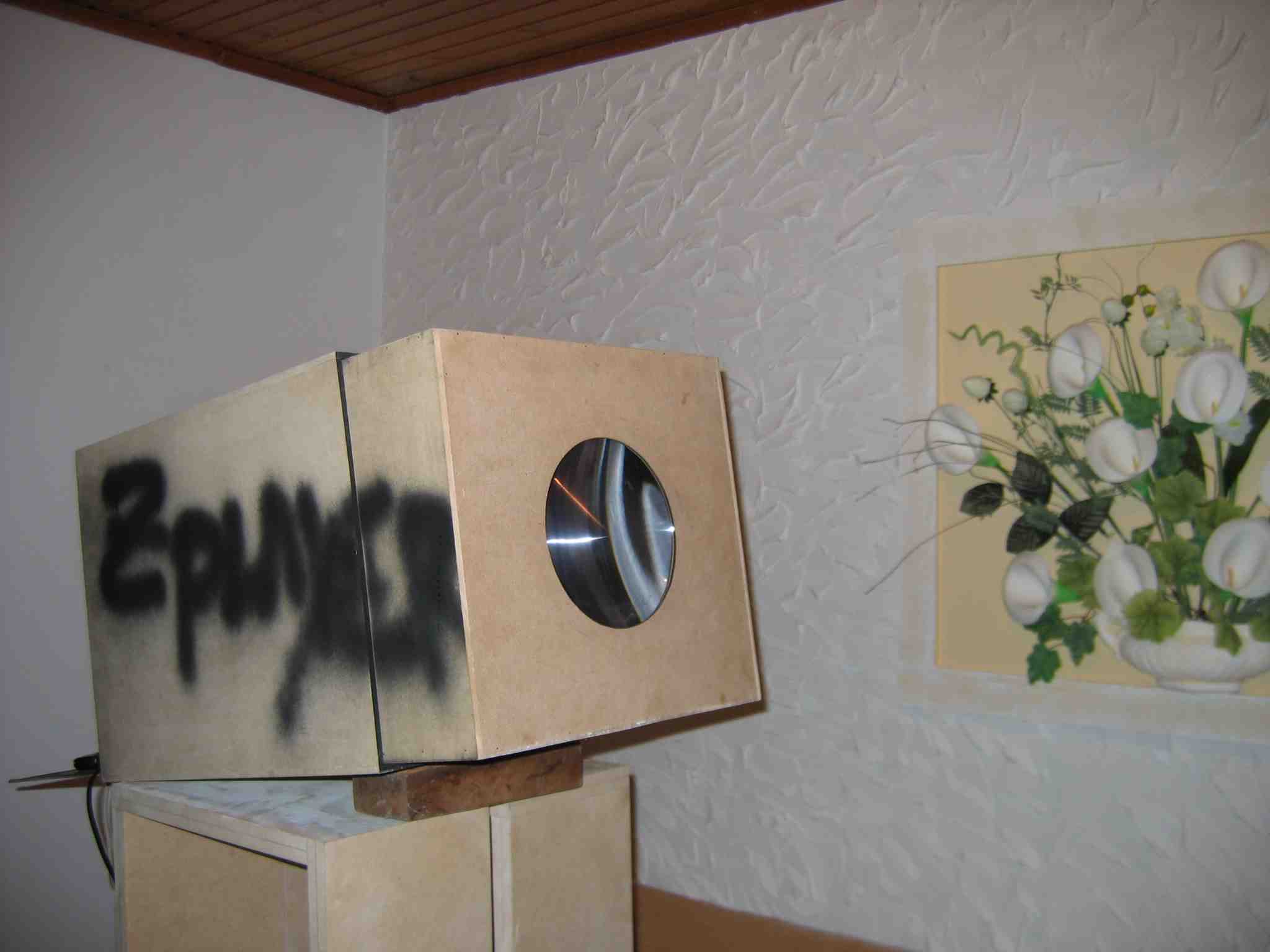

That appears different than the ones I remember. They just used the CRT for light.
Very dim when projected to any size at all.
I saw a neat article a while back on converting a used LCD screen from a laptop to use for a projector, along with a focusing lens, maybe similar. It used a quartz halogen for illumination, but probably melted down the LCD screen if not cooled sufficiently.
The only thing that worries me is that you seem to have a lot of pictures of that device.
From your front room?
Just kidding.
People are very inventive at times.
Sorry about Brazil's loss. -

LOL LOL - I got these pictures from the web (it's not my HUT)The only thing that worries me is that you seem to have a lot of pictures of that device. From your front room? laugh.
Cool, ins't it??
LOL LOL Anyway, the Brazilian model shown above is the most beautiful one and very fancy - Z (easy) Player - I sounds good! LOL
-Nah... no problem. Vive les États-Unis! Vive la France!Sorry about Brazil's loss.
SingSing
-Sorry for the late reply... Here's the site in Brazilian Portuguese where I got those pics. I guess they have uploaded "some pics" - not all of them - showing probably a real LCD projector in action instead of that E.T. (LOL)Can Cunhambebe post infomation how to get parts and info for the TV projector ? I am impressed that the TV is set up at upright. Can you show us in screen shot too ?
http://produto.mercadolivre.com.br/MLB-44690763-lente-projetora-transforme-sua-tv-em-u...ete-gratis-_JM
Pls scroll down to see the pics. -
how does the focus works on this suckerOriginally Posted by Cunhambebe
? or you have to move the table back and forth?
looks like a poorman missile defence system -
LOL - I guess you can slide back and forth the cover (with the lens).ooks like a poorman missile defence system
