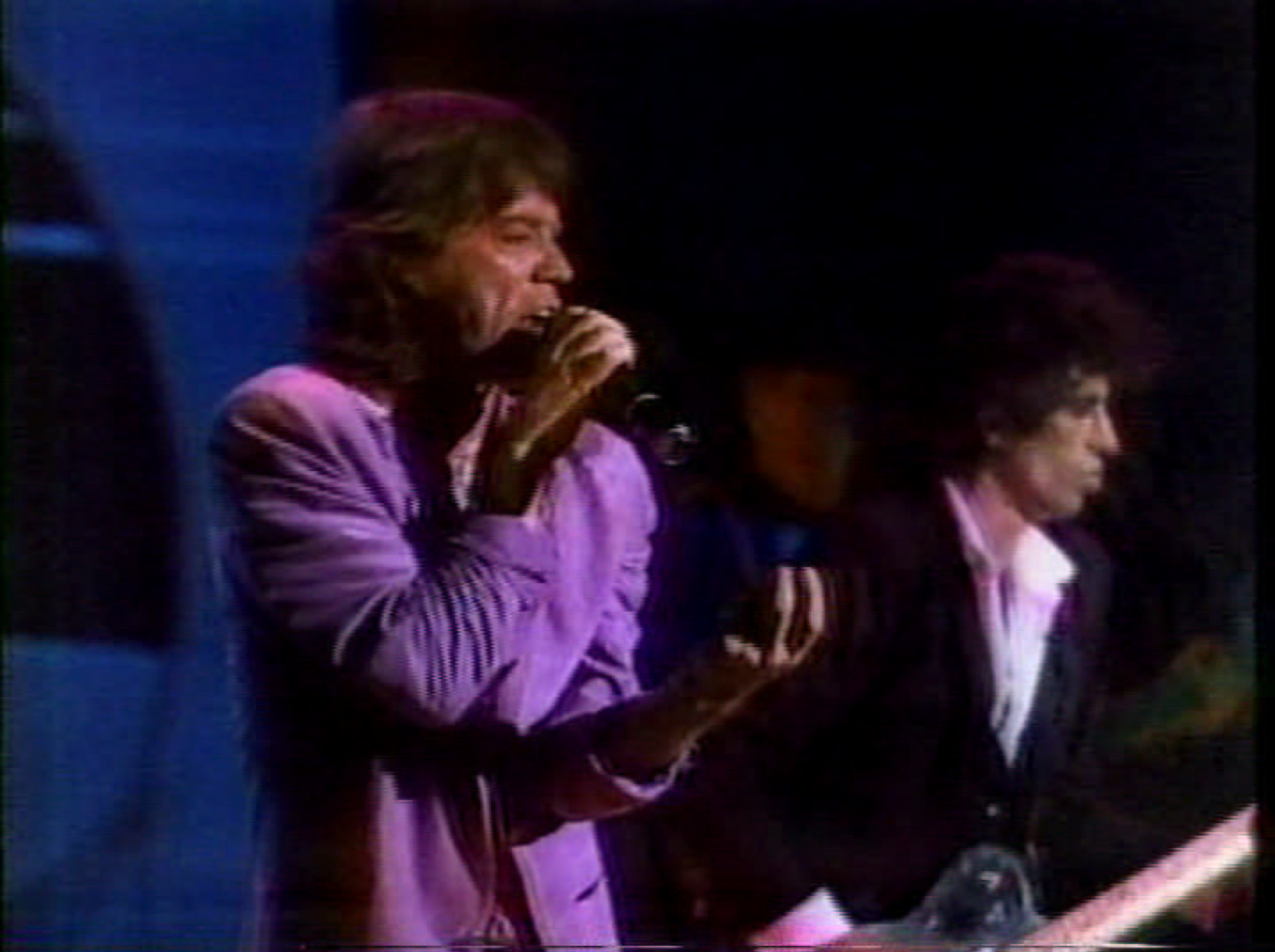

    Here's a clip from the Stones concert (VHS-two audio channels, recorded off of over the air Subscription TV with FM simulcast in 1981.

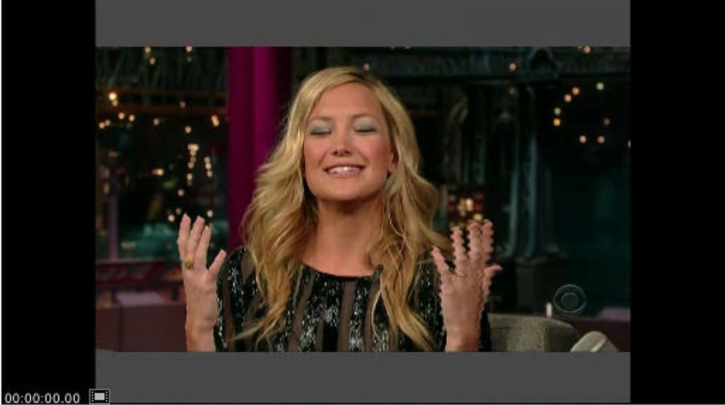

    I was really hoping that the MyDVDEdit tip would work, but alas it just stretches out the image. Compare this screenshot from The David Letterman show recorded at 480i as a Letterboxed image:

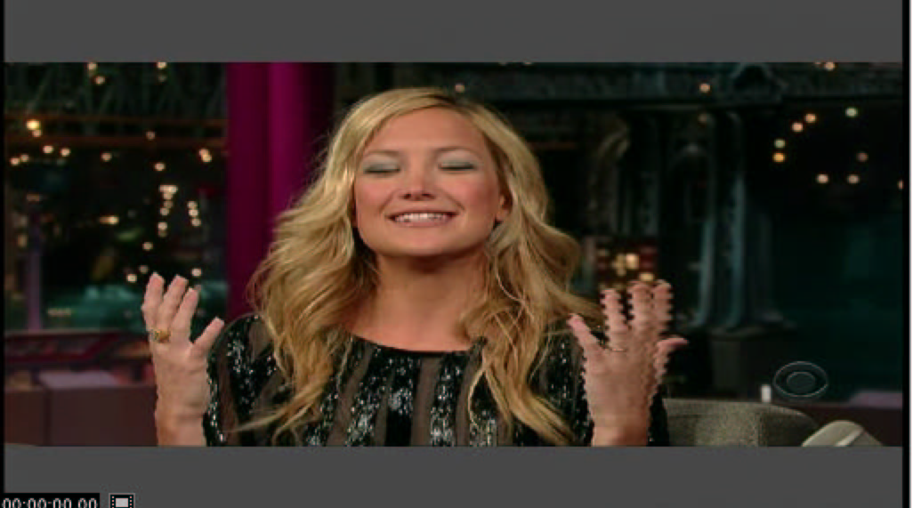

    To the same screenshot, modified with MyDVDEdit to 16:9 Letterbox. It appears the same way when I burn the clip to a DVD and then play it to my HDTV.
