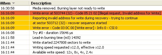

    I've been burning DVD's for a while now using ConvertXtoDVD and have never seen this problem before, was wondering if someone could enlighten me if they know what the problem is.
    "Write error at 0 (32) - 03 73 02 [Medium error, PCA Full, cannot write anymore]"

    It's a failure to write to the Power Calibration Area of the DVD near the center of the disc. You can only do this 99 times with a disc. Since you probably haven't done this 99 times with that disc, it's either a problem with the media or a problem with the burner. The burner does a power calibration of the laser with the disc to see what speed it can be written to before each burn. It's almost always a hardware problem, not related to the software you used.
    Try some different media first. It's similar to a power calibration error, but that error is usually because it couldn't complete the calibration. In your case, it couldn't start because it thinks no space is left there. If a different brand of media doesn't fix it, then your burner is having a problem. You could try cleaning the laser lens, sometimes that helps.

    Could the actual DVD files be what is causing my problem? because I used another disk and it ruined it just like it did the first time I burned this file. When I look at the disk it appears to have data on it but when I open it through my computer theres no data on the disk. I got this message when I burned the file.
    Also I trascoded and burned another DVD before retrying this one and it worked fine. Therefore I dont think its a problem with my burner.

    I tried transcoding in convertxtodvd and burning with nero since the convert.. wasnt working and after burning one dvd it worked fine. Now I tried again transcoded in conver... and burned with nero and now I got the message
    "session fixation error
    could not perform end of disc-at-once"
    this is the 5 disc its wated lol.

    Still sounds like shit media (or a bad batch, at least) or a problem with your burner, or perhaps a little of both.
    Have you got other media you can try ?
    Have you got access to another PC (a friend's for example) that you could put your burner in ?
    Try re-flashing the firmware on the burner ?
    Try creating an ISO Image with folder2iso and burning with IMGBurn ?
