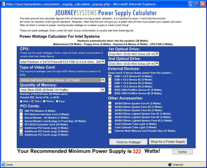

    Calculate how powerful of a power supply you need:
    http://journeysystems.com/power_supply_calculator.php

    Thanks for the link soopafresh.
    Looks like I should think about more power after all. I'm not sure what my celeron 2.66 actually is called but i chose a close power range and it's suggesting 320 watts.
