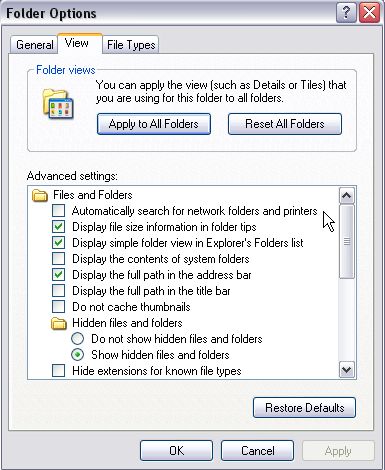

  5. Is "Boot Up Floppy Seek" enabled in your BIOS?If so disable it.
    Also untick "Automatically search for....":
