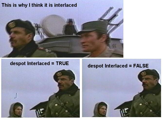

    I posted about this at doom9, but I thought I might increase my chances of an answer if I post here also. If this is inappropriate, please delete this post.
    I’m having some minor glitches using DeSpot filter in avs script in VirtualDubMod, didn’t find anything like this by searching, and I am hoping someone here has seen similar behavior and can tell me how to handle my interlace question.
    __1__ If frame height is more than 300, and Interlace is set to True, the filter misses most of the spots, even if it marks them correctly in SHOW mode.
    __2__ If I change Interlaced=true to FALSE, I get beautiful results, even with full frame size.
    If I change it back to True, the spots come back.
    Increasing pheight parameter does not help.
    __3__ If I crop to height of 300 or less, I get beautiful results, even with Interlace set to True.
    I opened VDM script editor, and changed crop height and interlaced settings back and forth, and watched the spots appear and disappear.
    I’m sure my clip is interlaced, I can see interlace artifacts .
    I’ve seen some posts where users like me said the filter didn’t seem to do anything. I wonder if we all have interlaced source clips.
    Would this be a bug, or is there another parameter I must change?
    I’m thinking I should set deSpot Interlaced parameter to False.
    But then, for ConvertToYV12, would I include parameter Interlaced = true?
    My source was vhs movie, captured from vcr with usb device, using DV Video Encoder in Pinnacle Studio.
    NTSC, 29.97 fps. Interlaced Frame size 720x480.
    The dirt spots in my 20-second test clip are in the sky, top half of the frame.
    Almost every frame has at least one big black spot, and almost every spot lasts two frames.
    I’m using deSpot v 3.5, in an avs script in VirtualDubMod.
    PC is P4 3.06 ghz, XP-Home SP2.
    Here's my script:
    path = "C:\Program Files\_Multimedia\_Video\AviSynth 2.5\plugins\"
    LoadPlugin(path+"despot.dll")
    AviSource("c:\__CAP\Test-22s.avi")
    ConvertToYV12(interlaced=true)
    # @@@ to increase cleaning ~~~ these have most effect
    # go lower from defaults seg=2, dilate=1, p1=24, p2=12
    # go higher from defaults mwidth=7, mheight=5
    #  What about INTERLACED ???
    DeSpot(interlaced=false, pwidth=35, pheight=70,
    \  p1=18, p2=10, dilate=0, seg=0,
    \ mthres=16, mwidth=20, mheight=15, merode=33, motpn=true,
    \ ranked=false, p1percent=0,  blur=1, tsmooth=3, show=0)
    Do a good deed today, and help a granny in distress
    Thanks in advance for any help.
    (adding some cropped screenshots just so you won't think I'm senile)

  3. Hi-
    Never used DeSpot and haven't a clue about what you're asking. However, I'm questioning your "proof" that your source is interlaced. Does DeSpot always work well with progressive sources? And if so, if your video comes from a progressive source, and you make it progressive again, wouldn't that help?
    OK, when stepping through your video frame-by-frame, is every frame interlaced when examining motion/action scenes? If so, then it really is interlaced, and you can forget I ever said anything. If, when stepping through it frame-by-frame, you see a pattern of 3 clean progressive frames and 2 interlaced frames in every 5 frame sequence, then it's from a film source and can be IVTC'd back to 23.976fps progressive, ready again for DeSpot.
    You said it's from a VHS movie, so I suspect it's supposed to be 23.976fps, can be successfully IVTC'd with one of the AviSynth IVTCs, such as Decomb, TIVTC, or SmartDecimate, and will (perhaps) solve your problem in a different way than you expected.

  5. Hi-
    As it stands now, it is interlaced. I'm suggesting that for encoder efficiency and quality purposes, with perhaps the side result that DeSpot will work as expected, you make it progressive again by IVTCing it.
    Might you mess things up by calling it progressive if it's really not? Yes, but since your source is a VCR tape, and the quality most likely isn't so good anyway, then the degradation may not be noticeable.

    You're right, and it looks like my source is telecined.

  7. Hi-
    as soon as I figure out how to do inverse telecine, that is
    You posted some really complex script above, and you're wondering how to do a simple IVTC?
    Go get the latest Decomb. Read the docs it comes with. They'll explain all you need to know. Load the Decomb Plugin.
    AssumeTFF()#if really TFF, AssumeBFF() if BFF
    Telecide(Guide=1)
    Decimate()
    The docs will explain how to tweak it some more if you find it necessary.

    Just reporting back that DeComb did the trick.
    I only used the Telecide component, and kept the 29.97 fps frame rate, so Pinnacle Studio 9 is happy with the clip, and life is wonderful again.

  10. Hello-
    If it's a film, and if you apply Telecide only, if you step through your video, you'll find that every fifth frame is a duplicate frame. This will give the video a strange stuttering motion during certain kinds of movement.
    Better would be to follow Telecide by Decimate (as in my earlier script), in order to remove that dupe frame. This will then give you progressive 23.976fps when encoded. During the encoding or afterwards you apply pulldown to have that 23.976fps video output 29.97fps. That will be accepted by your authoring app.
    You can use DGPulldown with the default 23.976->29.97fps setting after the encoding is complete.
