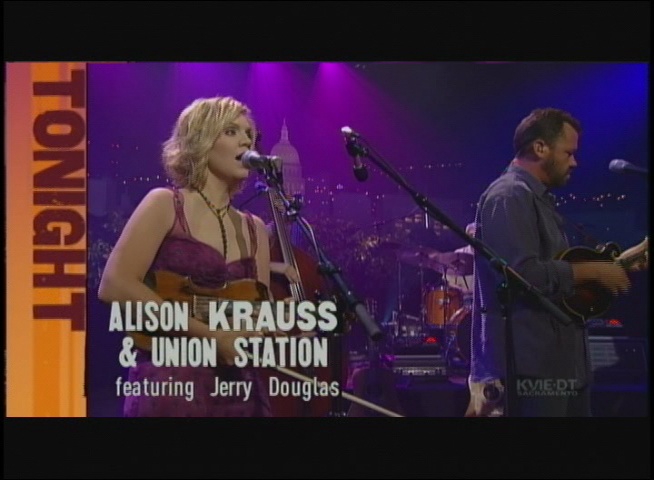

If you're not yet watching HDTV programming, then you're missing all the fun!
This is like when Color TV coexisted with B+W.
Sometimes the images are absolutely incredible. -
Some of the best stuff is on Discovery-HD. And then there are the oddball shows like the Sunrise series on InHD.Originally Posted by davideck
