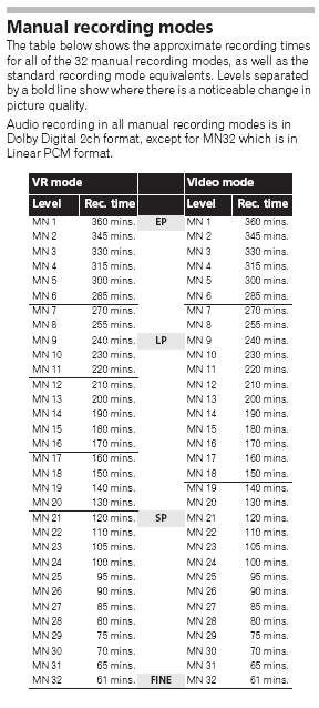

Here are the recording times for the Pioneer DVR-310
The right column is the side you want to look at as the left column is VR mode which is not suggested. In other words always use DVD Video mode instead of VR mode.
As for how to read the chart in terms of resolution ... up to MN 19 uses Full D1 resolutioin (720x480 NTSC). The MN 18 thru MN 7 uses Half D1 resolution (352x480 NTSC) ... MN 6 thru MN 1 uses "VCD" resolutiion (352x240 NTSC). The MN numbers are from the right side of the chart (DVD Video mode).
