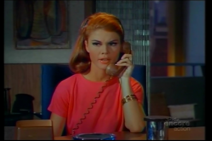

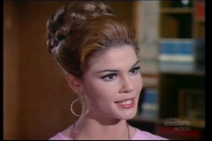

	Here are a few new before and after screen captures from the same source.
 Delogo settings were with alpha to repair at zero (off), nothing else changed from the default.

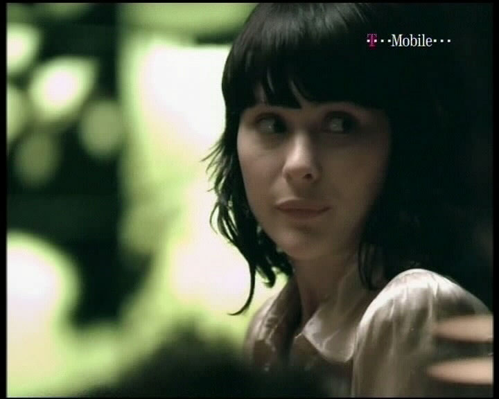

 Post a screen capture of the logo you are trying to remove and I will see what can be done. Also post a screen capture with the logo on the black background.
	Barnabas
 You said for solid logo, we should better use deblend and repair at first time, well how we should use deblend and repair? Do they have the same method like Delogo? Should we prepare 3 images like before?
	Shahram,

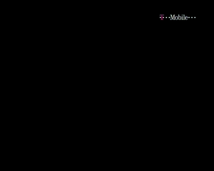

 How were you able to capture the logo on such a totally black background? Remember, the logo frame capture, MUST be from a frame that is showing ONLY the logo on a black background. It won't work to capture the logo and paste it onto a black background.
 Here is the mask I made for this logo.
	Barnabas
 This image is from an advertising, I exported one frame (as you see) and then took it to Photoshop and with lasso tool select the logo and then reverse the selection and fill it by black color and finally save as it as new image, was it wrong way?
 You said: Remember, the logo frame capture, MUST be from a frame that is showing ONLY the logo on a black background. It won't work to capture the logo and paste it onto a black background.
 I didn’t understand it, was my way wrong? How do you make black background for a logo?
 How can I find a logo frame with black background when there is not such as this frame in video?
	Shahram,
 I see, I thought that might have been how you made it, as the black has totally solid zero RGB values.
 In order to have the program make the BEST working deblend mask possible, which is THE most important of the 4 masks that DeLogo makes, the video needs to have a few frames that you can select from where the logo is fully showing, but the video is otherwise black, like where a movie fades to black. It will NOT work to simply paste the logo on a totally black screen. It's actually pretty easy to find the logo on a totally black screen when the logo is displayed for the whole program, but difficult to impossible at times to find a totally black screen for some videos that intermittently display the logo.
 For videos where you just can't find a totally black screen, the next best choice is to try to find a part of the video where at least the portion of the screen where the logo is located is black, and make your red mask from it.
 For videos that just don't have ANY instances of the logo being displayed on a black screen, you will have to go with Delogo's automatic analyzer, and tell DeLogo which frames contain the logo. Sometimes, it can create a pretty good mask like that, sometimes not, but it's the only way to get working masks if your video doesn't have the logo displayed on a black screen.
 One tip, if you must use the automatic analyzer, and don't get good results, take a look at the alpha mask delogo made. It seems to usually select the first frame it sees for part of the mask, and if that does not at least have the same general color over the spot where the logo is, the mask is usually not good. In that case, select a different frame to start the automatic analyzer on, one that's at least fairly uniform.
