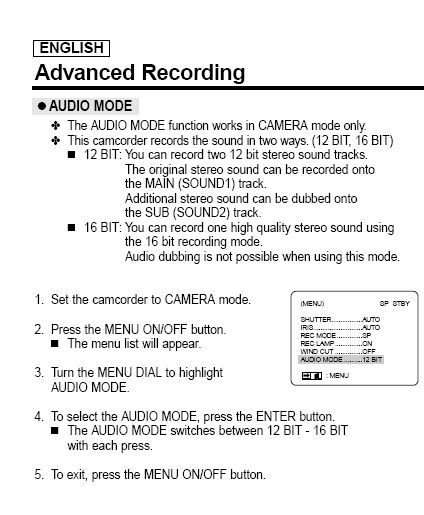

I carefully read through the owner's manual and checked all the menu settings for my camcorder. There is no setting for the frequency. The only settings for audio are 16 or 12 bits. I did some test recordings as suggested and posted the files at my website at http://web.ncf.ca/fg900/tempvid/

All consumer models that I have seen limit options to 16bit/48KHz (one stereo pair) and 12bit/32KHz (2 stereo pairs) and the Samsung appears to be no different judging by the modes offered in the manual. They are weak in their specs sheet.
http://www.samsung.com/download/FileView.aspx?cttfileid=29561&type=Camcorder&typecode=...e=UM&language=
