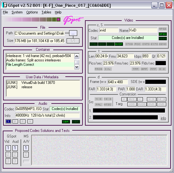

If the source framerate (25fps maybe) is different from the framerate at which you chose to encode (23.976fps maybe), that could explain it. You can check the source framerate by opening the video in GSpot. You set the destination framerate in your encoder. You may be able to get the final framerate by opening the output (MPV, M2V, whatever) in GSpot. Or check your encoder settings.

ok then, the source framerate is 23.976 fps, and the rate I'm encoding at is the same thing.

Your source is XVID, but it could be corrupt, as many are... -
