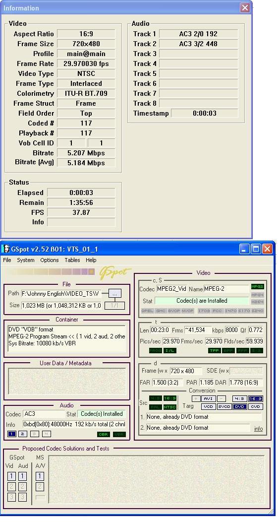

Can you use g-spot 2.52beta and post a screen shot to confirm that it is 29.970 ? g-spot will tell you the actual framerate, as well as the display framerate. I suspect that you are only seeing the latter at the moment, and the source is already progressive.
That said, between deinterlacing and reducing the bitrate to a very low level, you can only expect to see artifacts and low quality image.Read my blog here.
hai guns1inger
thank for reply... i used DGIndex to find whether the video is interlaced or not.. it say interlaced (screenshots below).. in gspot it say like Pics/sec = 29.970 , Frms/sec = 29.970 , Flds/sec 59.939..... what i have to do get good quality video as output... for the required 1.40GB... video length approx 1:24:05......... it says NTSC... help plz

Johnny English is a movie, and the true framerate is 23.976fps, but it's been encoded as already telecined and interlaced 29.97fps. The screenshots you posted show only how it was encoded, and not what the source is like. There's no way to fix it using DVD-RB. You'd have to do it manually using an AviSynth script with IVTC applied. Both of the options you tested in DVD-RB are the wrong things to use. Why are you trying to reduce movies to less than 1.5 GB anyway? I'd bet dollars to donuts that both of the DVDs you mentioned are bootlegs created by idiots.

If it were really interlaced, then every single frame would be interlaced. It would have been created using 30fps interlaced video cameras. Movies are shot on 24fps film. Sometimes these 24fps movies are telecined prior to encoding. Not the R1 DVDs of major movies, but some lousy bootlegs such as you have. The studios released these movies (16 Blocks for sure, don't know about Johnny English as I haven't seen the DVD, but probably it as well) encoded progressively at 23.976fps, with pulldown applied to output 29.97fps. But like I said, sometimes they are telecined prior to encoding. The way you check is to open a vob in VDub(Mod) and scroll to a place with movement/action. Advance a frame at a time. Rather than it showiing every frame as being interlaced, instead you'll see 3 clean progressive frames and 2 interlaced frames in every 5 frame sequence. 3-2-3-2. IVTC (Inverse Telecine) can be used to restore the progressive frames at 23.976fps. This will allow better encoding efficiency and a better looking backup.
Maybe the 16 blocks you had was encoded progressively. I don't know, but you seemed pleased with your DVD-RB result. From the way you describe it, I don't think Johnny English was encoded progressively on the DVD you have. Your first step is to examine the frames to see if it has that 3:2 pattern I described, or if all the frames are progressive, or if maybe something else is going on, such as frame blending.
