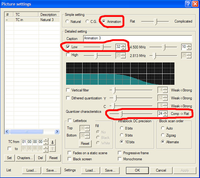

Make sure you aren't using too low a bitrate - keep the content to 90 minutes or less if possible. Use 3 pass VBR - some say 4 or 5 passes seems to cancel out the noise - debatable but up to you to test. Set you DC Precision correctly - Adam has some posts on this but if I remember correctly, 10 is for bitrates of 9000kbps and over, 9 for 7500 - 9000, and 8 for anything under 7500.

Use a better quantization matrix than the default Standard Matrix.
Use a spatial filter that doesn't hurt detail too much, like maybe Warpsharp.
