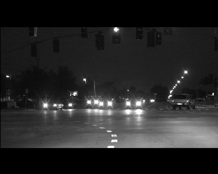

Try this .BAT file: Download (Right Click). Unzip/Unrar
_run_for_peterk.rar
This should properly give you a 16:9 image with black top and bottom borders at 720x576
If you don't want the letterboxing, delete the line that says "Addborders"
The PicVideo Mjpeg will require testing.
Change this line
for %%a in ("*.avs") do avs2avi "%%a" "vid-%%~na.avi" -c LAGS
to this (I think)
for %%a in ("*.avs") do avs2avi "%%a" "vid-%%~na.avi" -c MJPG
