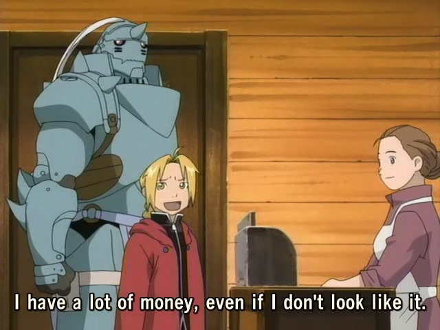

Full Metal Alchemist (Original AVI is 640x480)
Original AVI

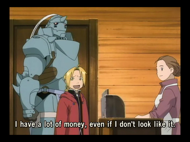

AVI resized to 608x448 then black added to make it 640x480

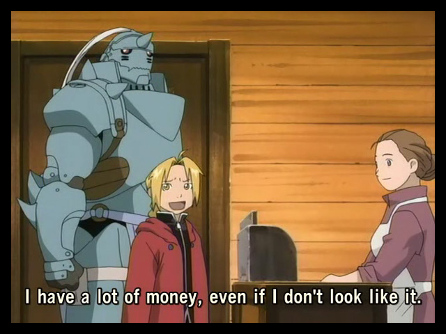

AVI resized to 576x432 then black added to make it 640x480

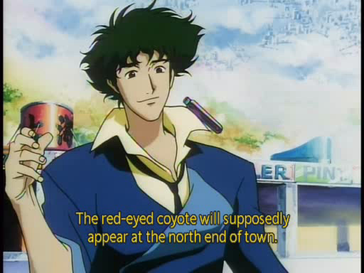

COWBOY BEBOP (Original AVI is 512x384)

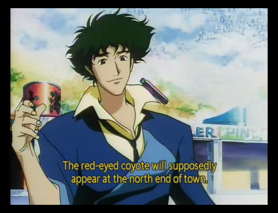

Original AVI
AVI with black added to go from 512x384 to 544x416
I used COWBOY BEBOP because it was on my HDD and it was 512x384 but notice that the subs here are actually well done ... one of the few that really would not need to be resized to see the subs on a TV. But you get the point.
