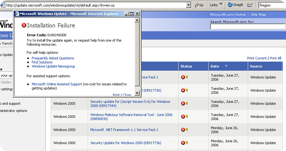

Please help me with this problem. my dvd drives need new drivers(I think) but for some reason my windows updates are not downloading. These two problems seem to have happened around the same time. I have done a bit of googling, but can't find drivers. Can anyone email me them? Or better still, tell me how to fix my update problem.
I am running W2K sp4 pro.

After a lot of googling I am still stuck. Can anyone tell me how to locate and fix the "Upper and lower filters"?

How about having a go at the window update problem, it's still not updating?"Whenever I need to "get away,'' I just get away in my mind. I go to my imaginary spot, where the beach is perfect and the water is perfect and the weather is perfect. The only bad thing there are the flies. They're terrible!" Jack Handey -
think m$ stopped automatic support for win2000, but i may be wrong. have you gone to update.microsoft.com to see what happens if you go there manually?

What error message are you getting, if any, for failed updates? A Google search for "Windows 2000 - Windows update fails" found several possible answers depending upon error message received.

Thanks, fritzi93 showed me a site that I can download from which did the trick. But it's still puzzling why I can't get them from MS site.

Do you have any of the services that pertain to windows update disabled? The services are background intelligent transfer service, and automatic updates. If you have any of these diabled, windows update will compain.Originally Posted by tweedledeeBelieving yourself to be secure only takes one cracker to dispel your belief.
