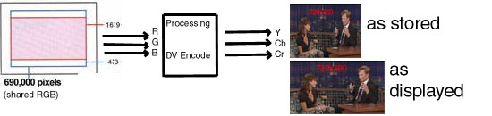

    The TRV 80 is outputting YUV in the form of DV format (YCbCr). Internally, the CCD optically captures RGB off a single CCD using optical separation techniques.
    Typical single CCD DV camera (this one shows wide mode):
    The RGB is processed into YUV DV format and sent over the IEEE-1394 connection to a DV-AVI file where the data is stored as YCbCr (4:1:1 sampled 720x480i/576i 29.97/25 fps with 16bit 48KHz uncompressed PCM stereo audio).
    Up to that point, you have 8 bit YUV. Broadcast oriented software works in YUV from there. Computer graphics based software often converts everything to 0-255 8 bit RGB (with losses). More sophisticated software can work in YUV/RGB spaces with near lossless conversion from one to the other. Find correct formulas at http://www.fourcc.org/
