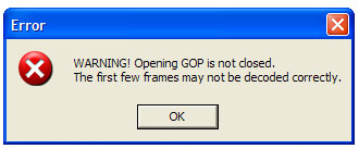

    I downloaded yxcv.demuxed.m2v and ran it through DGIndex [Version 1.4.6] to get a D2V project file. I would like to point out that when I did this I got the following error message:
    This is probably due to the way you "cut" the M2V file. So I wouldn't worry about it really.

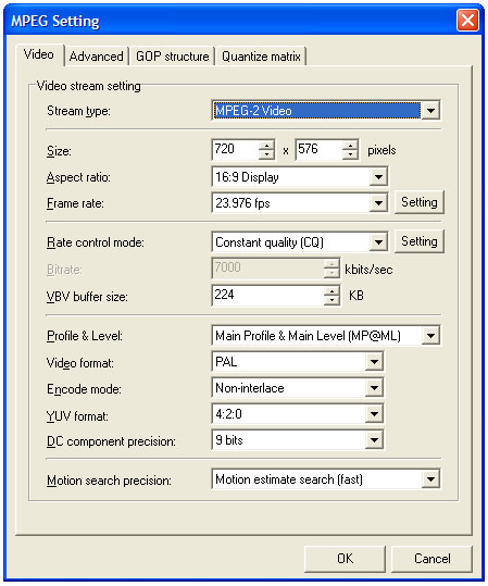

    6.) Click on SETTINGS at the bottom which brings up the MPEG SETTING window.
    There are a few things you need to change here. On the TAB called MPEG SETTING the ASEPCT RATIO is at the deault of 4:3 so change that to "16:9 Display". The Frame Rate is at the default of 25fps. CLICK ON the SETTINGS icon next to that and change it to "23.976fps". The Encode Mode is on the default of INTERLACED so change that to "Non-Interlaced".
    It should now look like this:
    Now you also have to change a few other things. For instance you probably want to do a 2-pass VBR encode so you need to change the RATE CONTROL MODE to reflect that. You also might want to change the DC COMPONENT PRECISION to 10 (although some people prefer to use 9 unless they are using very high bitrates i.e., a CBR or AVG of 6000kbps or higher). You also probably want to change the MOTION SEARCH PRECISION to something other than the default ... I suggest using the setting called, "High quality (slow)".
    Since this is a very short sample you have to do a CBR as it isn't long enough to do a 2-pass VBR so I set it up as a CBR using 8000kbps as the video bitrate. I used 10 for DC COMPONENT PRECISION and I used "High quality (slow)" for the MOTION SEARCH PRECISION.

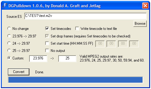

    In my case I called the AviSynth AVS file "test.avs" so in the end I get a MPEG-2 file called "test.m2v"
    Then we run the M2V file through DGPulldown ...
    We get a new file (in my example) called "test.m2v.pulldown.m2v"
    This file is now 100% PAL DVD compliant but the "playback speed" is the same as the original NTSC video so there is no need to adjust the audio (i.e., you do not have to speed up the audio).
    Playback is very smooth for me despite the bit of video blending that happens in those last very two scenes of the clip. Again that may have to just be left like that or you might have to fool around a bit more with the DeComb settings. Sorry to say I am far from an expert when it comes to using DeComb so you are on your own. If that "broken pattern" only happens here or there then you may just have to live with it (the slight blending/ghosting that happens when that pattern comes up in the video).
