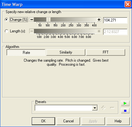

One last thing ... since you are speeding up the frame rate from 23.976fps to 25fps then the audio also has to be sped up.
The easiest and best way to do this ... in my opinion ... is to take the DVD audio and convert it to a standard 2 channel (mono or stereo) 16-bit 48k PCM WAV audio file.
Now open that audio file with GOLDWAVE and use the function in GOLDWAVE called TIME WARP. Set it up like in the image below:
Now save to a new 2 channel 16-bit 48k PCM WAV audio file. At this point you can convert to AC-3 format if you like although for editing you might want to keep it in WAV format.
Anyays this method of speed up is the same one that is used for speeding film up (from 24fps) to the PAL standard (25fps).

also is there a way, after having speeded up the audio to 104 % to integrate it also in the script. basically meaning i have one script that also already has audio, subtitles and 16:9 format.

- the issue of speed. The film is 4 % faster which is noticable (voices higher and quicker speaking).
4 % may not sound much but it is noticable if you know the original speed. ie. my film is 14:07
and now it is 13:33 minutes. is there a possible solution to keep the speed?
even thought procoder express does a poor ntsc to pal convertion due to blending the lenght does however
still stay the same.
