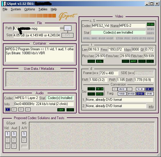

If it works this time, here's a screenshot of GSpot. If you need the other, let me know.
Please tell me if it worked this time. I think I had spaces in file name on the first try. -
Well the GSpot screen shot did in fact work

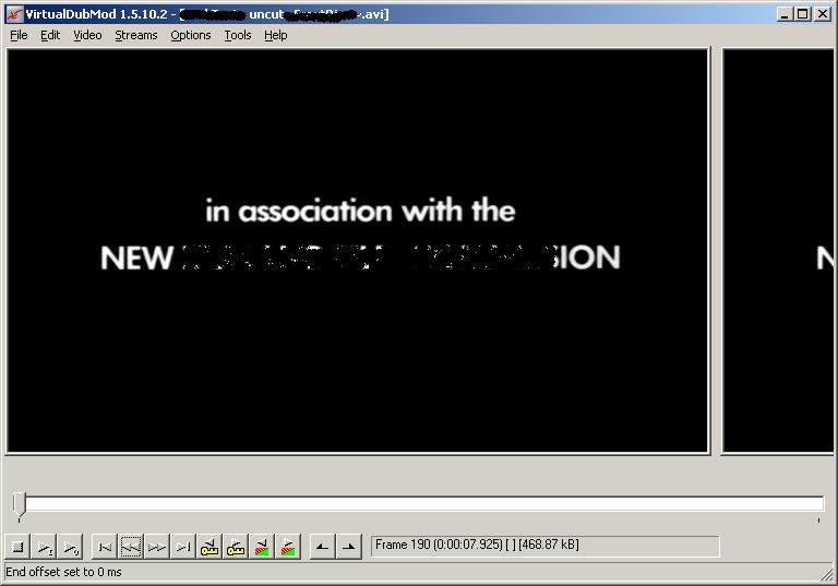

And here's a frame from the AVI file as it appears in VirtualDubMod. I hope this is what you meant; I simply found the frame I wanted, and then used Alt+PrntScrn. Also, when you said to capture the same frame from the AVI file and from the MPEG2 file, did you mean the same frame number? Because they don't match. This was frame number 190 in the AVI file, but it was frame number 200-something in the MPEG2 file. Anyway, here it is, with the frame from the MPEG2 file to follow.
screenshot_%20avi_in_vdm.jpg -

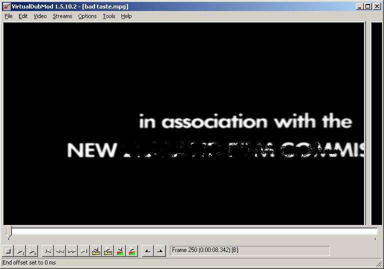

And finally, the screenshot of the MPEG2 file as it appears in VirualDubMod.
Hope this helps. Like I said before, I've found a few other files that have the same problem when converted.

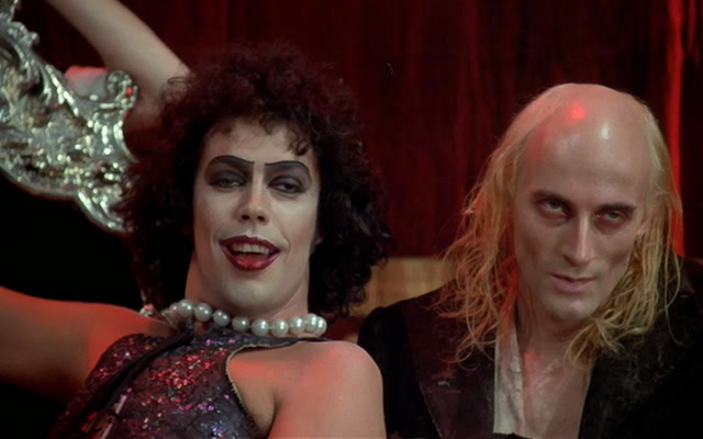

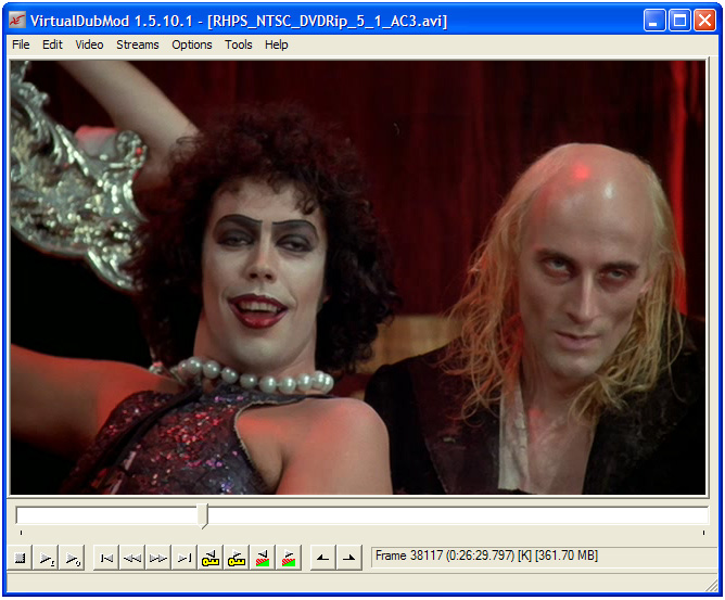

In the future don't do a screen grab of VirtualDubMod the way you did. Instead go to where it says VIDEO across the top. One of the options under VIDEO is called COPY SOURCE FRAME TO CLIPBOARD. Then you load up an image editing program (hell even Windows PAINT will work) and do a PASTE ... then save the image as a JPEG file.
So instead of seeing this:
We get a much better image like this:
