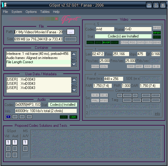

That said, I suspect that your problem is likely to be format - specifically mixing NTSC material into a PAL disc. Can you use the latest version of g-spot (2.52beta) to tell us what you video is ?Read my blog here.
hi
the 2 videos im using are avi files. i think they are both ntsc, but i used xilisoft to convert them to pal as TMPGEnc wont load them. by using xilisoft i set the properties to standard
al, bit rate:2000, frame rate:25, and sample rate 48k. is it in the settings here? cuz its still comes up in an error in dvd lab that i can ignore that the films are ntsc.
so i am not sure whats going wrong, and where do i look for the information u need in g-spot, and do i load the orginial avi file, or the converted mpeg-2 file. many thanks

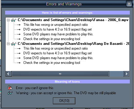

one thing i noticed, is that even when i change the aspect to 4:3, dvd-lab still comes up with an error saying that the apect flag is not correct.

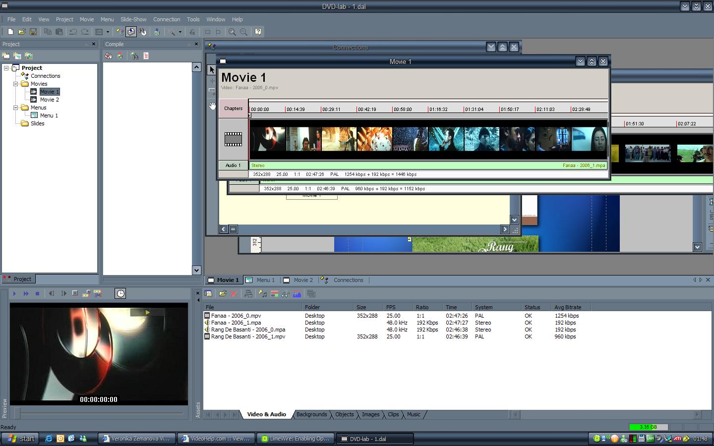

Can you post some screen shots of
1. DVD Lab Pro with the video loaded
2. The DVD Lab Pro project settings
3. The error message

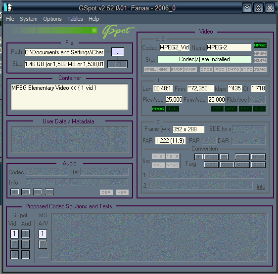

4. A new g-spot of the video you are using
Also, what happens if you play the converted video on it's own ?Read my blog here.

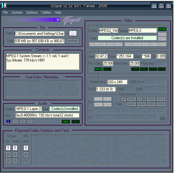

and finally the shot of g-spot of the file i am now trying to use
thanks for the help
g-spot.bmp -
The video is now valid, however DVD Lab is obviously not quite happy with it. The first thing to note is that these are not errors, but warnings. They will not stop you compiling the project. The problem still appears to be your encoder, which seems to have either not included an aspect ratio, or has put 1:1 in the header. I would try DVD Patcher, and use it to put a 4:3 aspect ratio into the mpeg files.
What happens if you run the mpeg files on their own, before compiling them in DVD Lab ?
What version of DVD Lab is this ? I use DVD La Pro, which has an extra option in the project properties to explicitly include SIF (VCD resolution) material in the project. You don't seem to have this option.Read my blog here.
