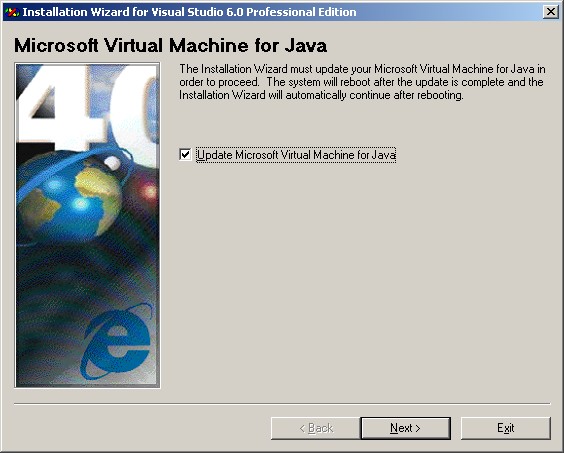

Here's a funny story, though, and I did not see this software mentioned in the thread. While sifting through some old code I decided to dust off the VS6 disks and install to check out the sources I found. I have run VS6 under SP1 of XP just fine. VS6 does not install under SP2. What is interesting is the timeline of nearly 9 months Microsoft was "officially supporting" VS6 but never truly released an upgraded installer to correctly address MS Java. Upgrading SP1 to SP2 with VS6 installed works fine - just cannot install afterwards.

I also have (and still use) VS6 Pro Edition, and it has installed fine on 3 x freshly-installed Win XP with SP2 slipstreamed PCs. When I start the installer and enter my details, I get the following message:
... and then it upgrades the VM, reboots and continues to install (and operate) without a hitch
If in doubt, Google it. -

Very interesting. When I drop the CD into the tray, I receive "Setup has encountered a problem and needs to close. We are sorry for the inconvenience."
The system was re-installed a few months ago from a slipstreamed XP SP2 CD. Following the original VS6 problem a few weeks ago, I tried the basics, such as disable AV, stop all programs and services, and reboot with no luck. Loaded msjava and patched it prior to installation with no luck. I tried copying the CD contents to hard disk and running SETUP.EXE in 98 and 2000 compatibility mode with no luck but at least it tried to register the files. Tried some Goodle workarounds with no luck, either.
From what I read, VS6 was designed for Windows '98. Problem is it worked under SP1 for me (slipstreamed) AND the product was supported officially by MS after SP2 was released. I will try formatting my machine at some point to see if it is something I did but there are plenty of Google articles on this same problem.
