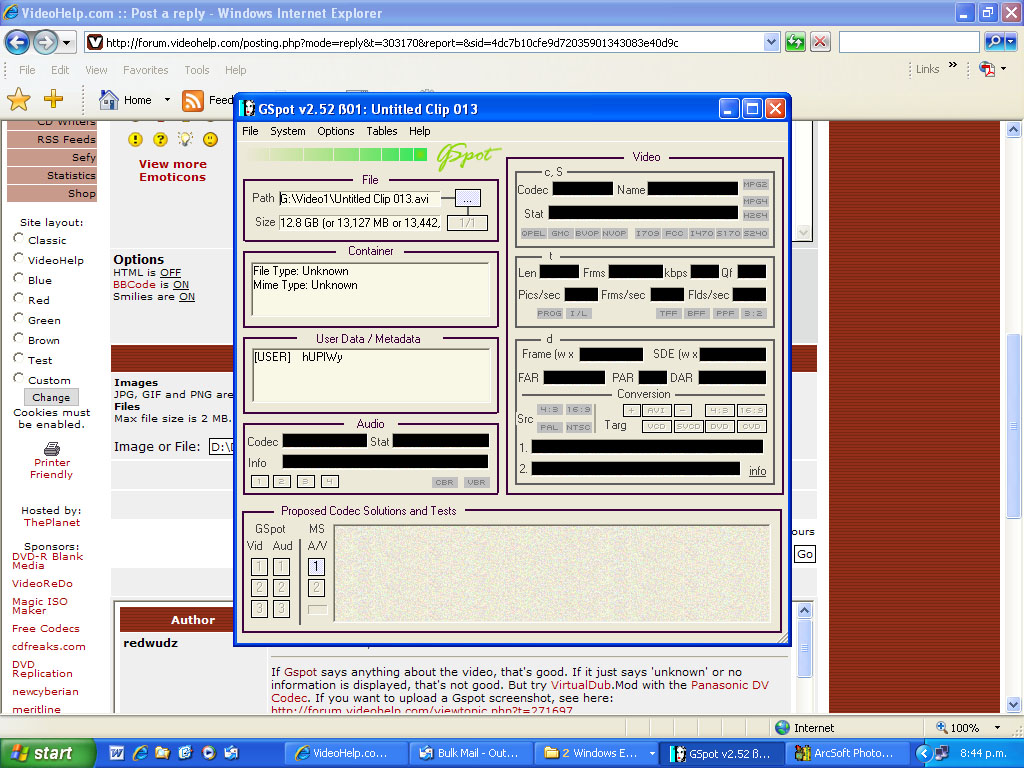

    If Gspot says anything about the video, that's good. If it just says 'unknown' or no information is displayed, that's not good. But try VirtualDub.Mod with the Panasonic DV Codec. If you want to upload a Gspot screenshot, see here: https://forum.videohelp.com/viewtopic.php?t=271697

    Screenshot of GSpot.
    Unfortunately it doesn't say too much apart from Unknown file type...
