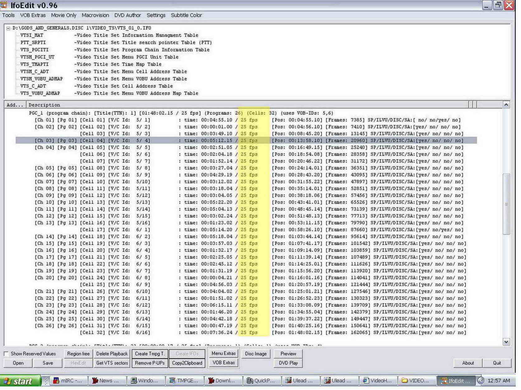

    I have ifoedit096 so I can edit the ifo files, however there are some aspects it wont let me change. Like the frame rate in the program chain (see pic). So I am unsure how to proceed there.

    Only problem with that is the $140 I just bought a house, and between the mortgage and the loans to fix the central air (which cost 6Gs), and to buy appliances, and furnishings,and a Riding mower for mowing 3.4 acres, etc that $140 is meaningful. As I see it, and again Im no expert, if all the VOBs are compliant with NTSC, then the only thing left that has to be changed or redone would be the ifo files. I am thinking that therein lies the key to the whole thing. There must be somthing that would let you rewrite the entire ifo file. From scratch if necessary, using the original as a template or guide.
